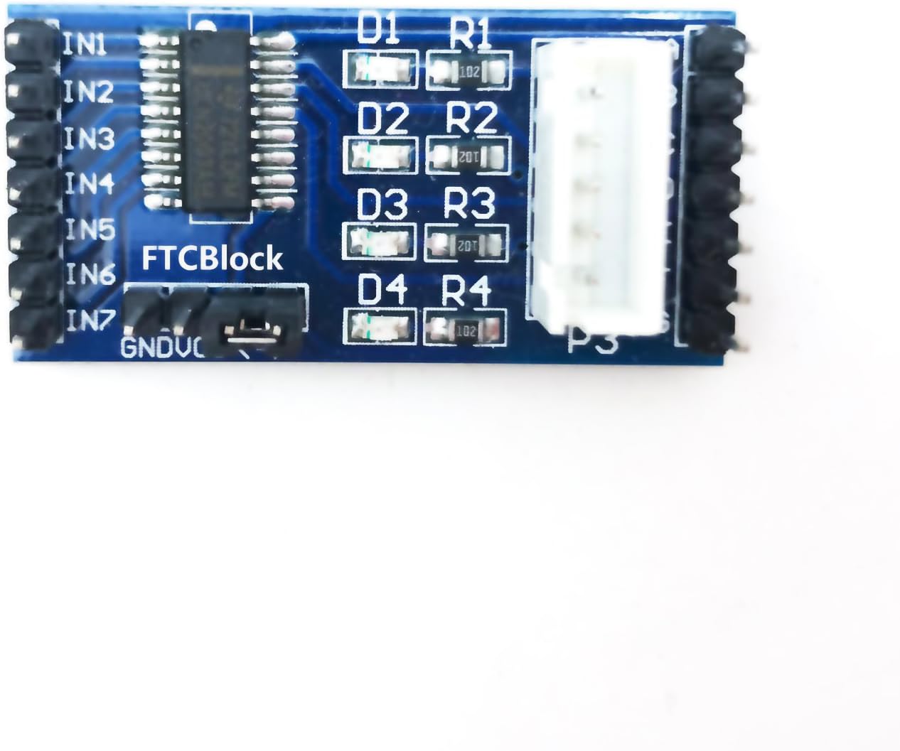

Sorry for English... I used the diagram from page 1
You then link the mega pins A8, A10 to A14 to a ULN2003A
then to the button lights.
Njz3 software then needs to be configured... an example is on page 10 message 158

marcus600
where i can find the small card for light control ?
