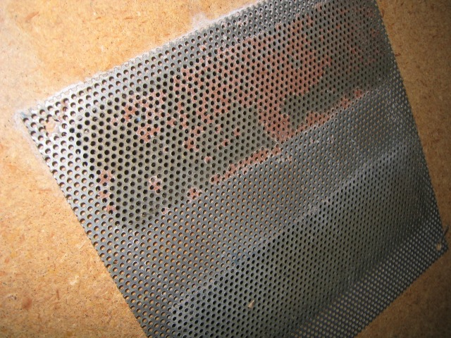

Citation de: DarthNuno-from-Drangon's-Lair-Fans
Have a look at the grills for air : full of rust ...  :?
...of course, rust on both sides  :?

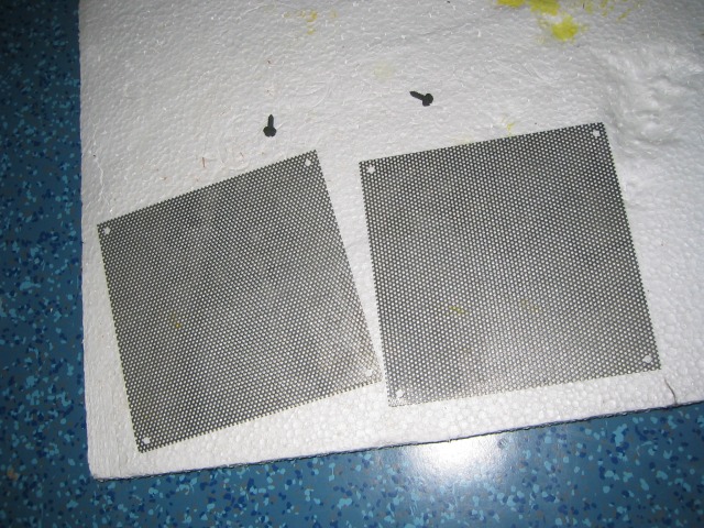

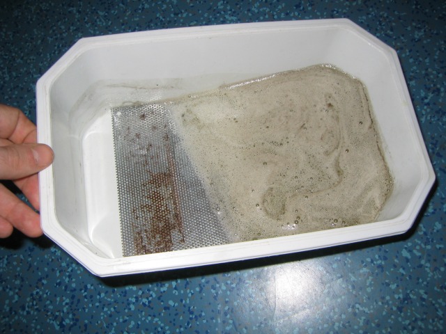

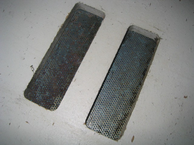

I'm using a special product to remove the dust... I just let 24 hours the stuff inside the 'magical' product  :)
Here's the result :
