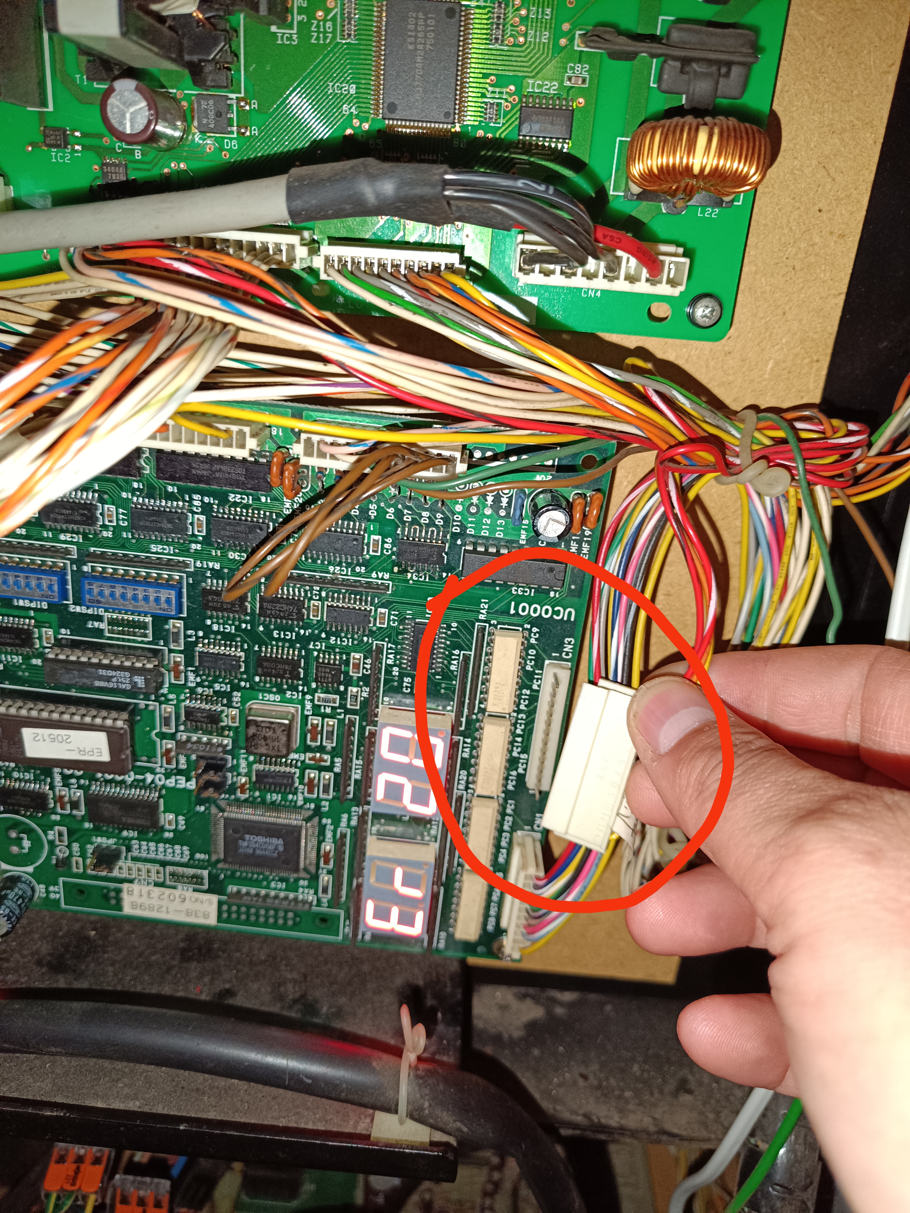

areni2002
The optocouplers also seem fine to me. Maybe the TD62384AP chips? I ordered new ones and the M6253 converter on AliExpress.
areni2002
Disconnecting CN3 had the same effect. I checked the optocouplers again and desoldered and checked IC28 – it's working. I'm still waiting for the new OKI and TD chips.
areni2002
I think the optocouplers are faulty. I tested them like the diodes, but everything was fine. I was surprised to find that on the diode side, without the connector connected, there was a voltage of about 2V. The meter showed over 200k ohms between the diode and the transistor. This only applies to the optocouplers behind the CN3 connector. Let me know what you think. While I don't have the parts, can this optocoupler be replaced with another one?
