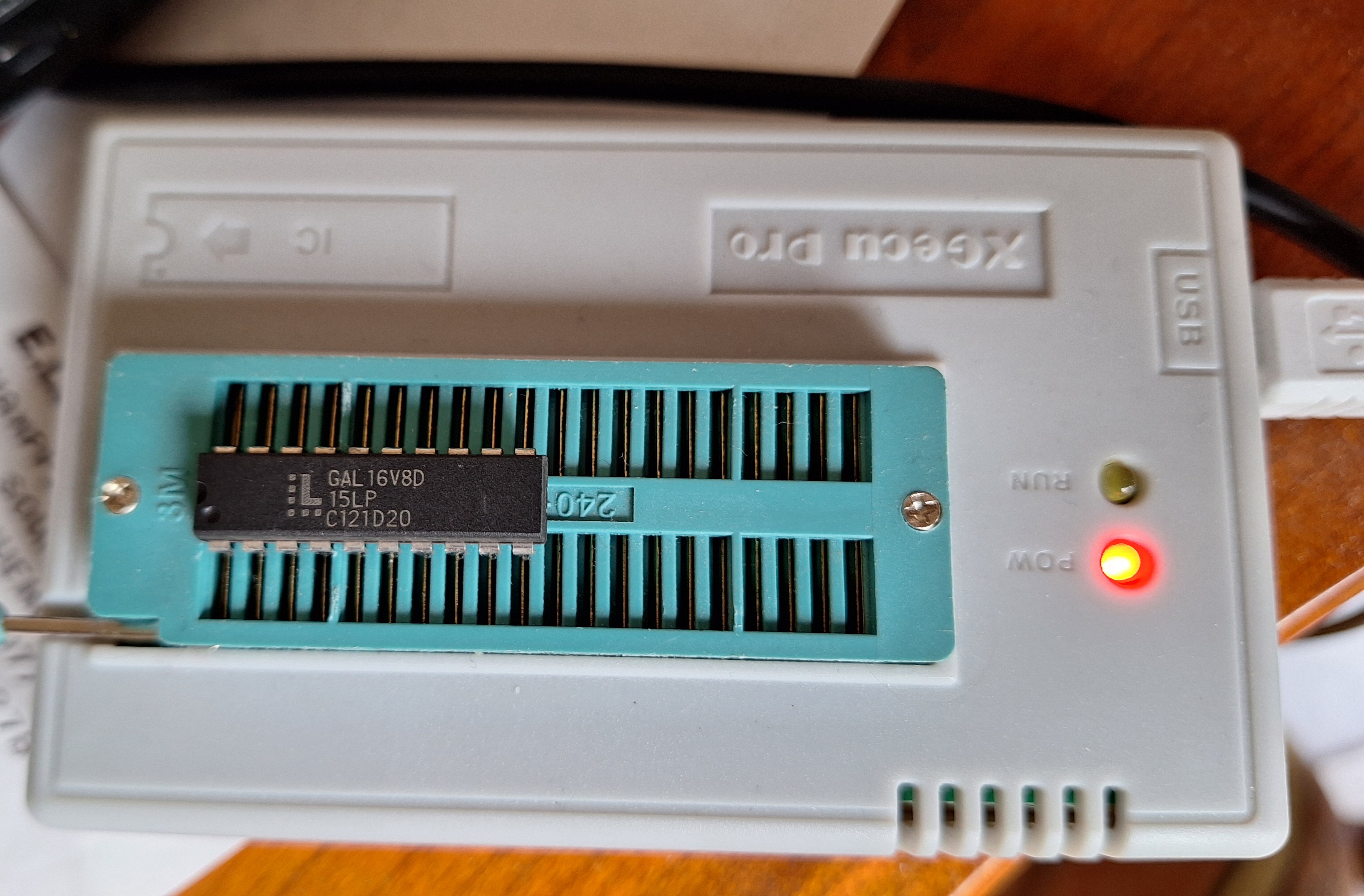

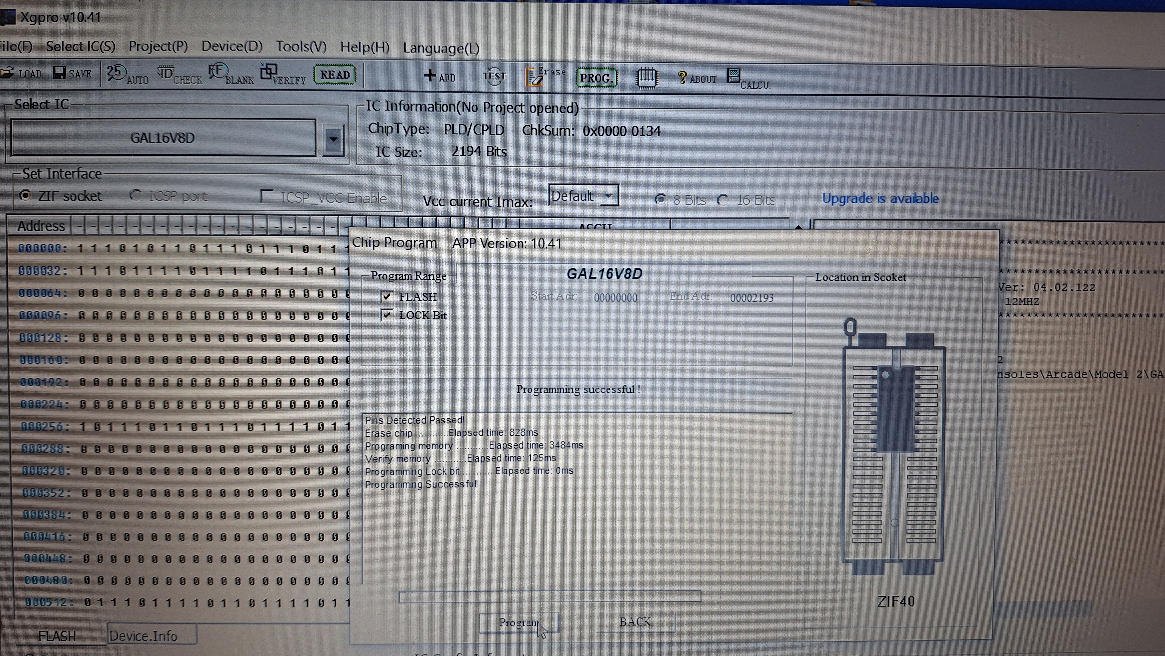

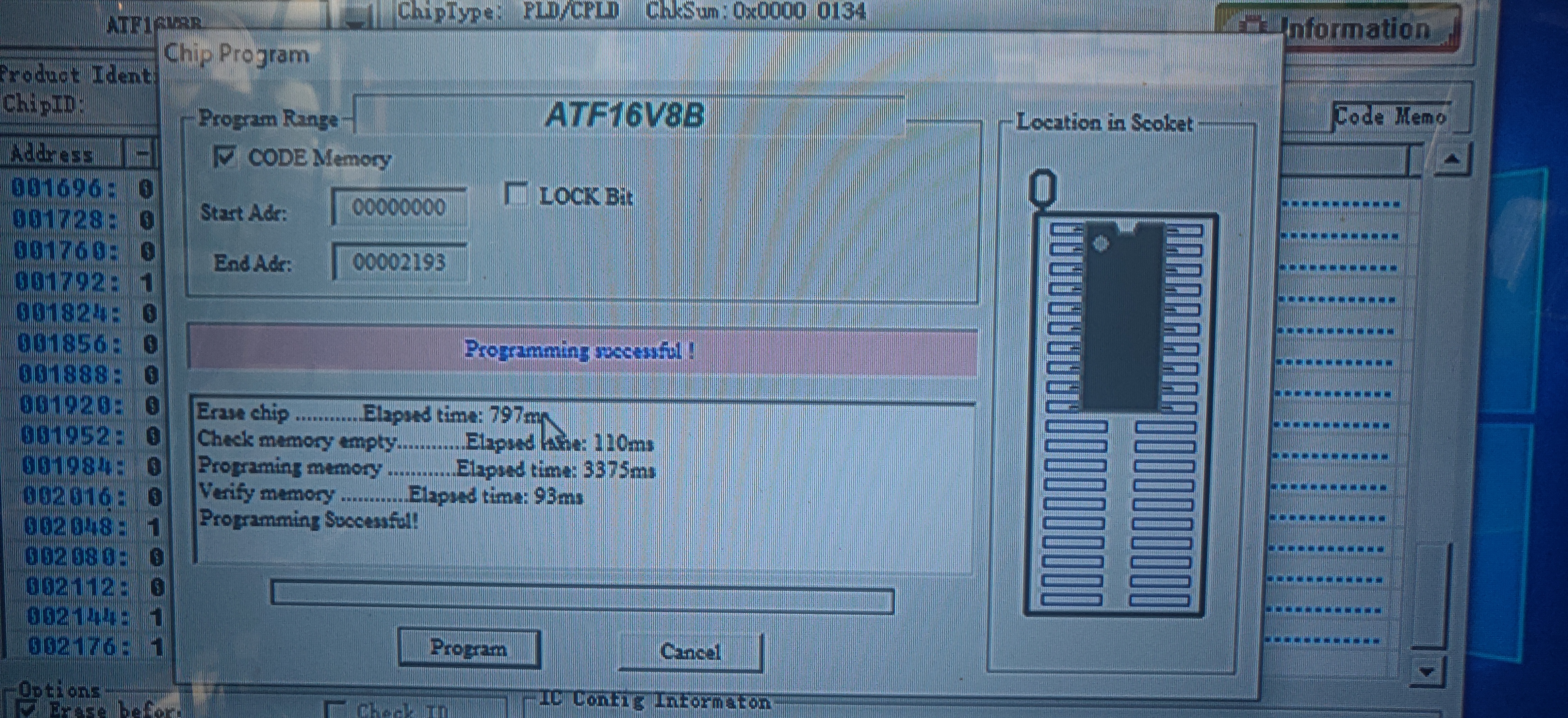

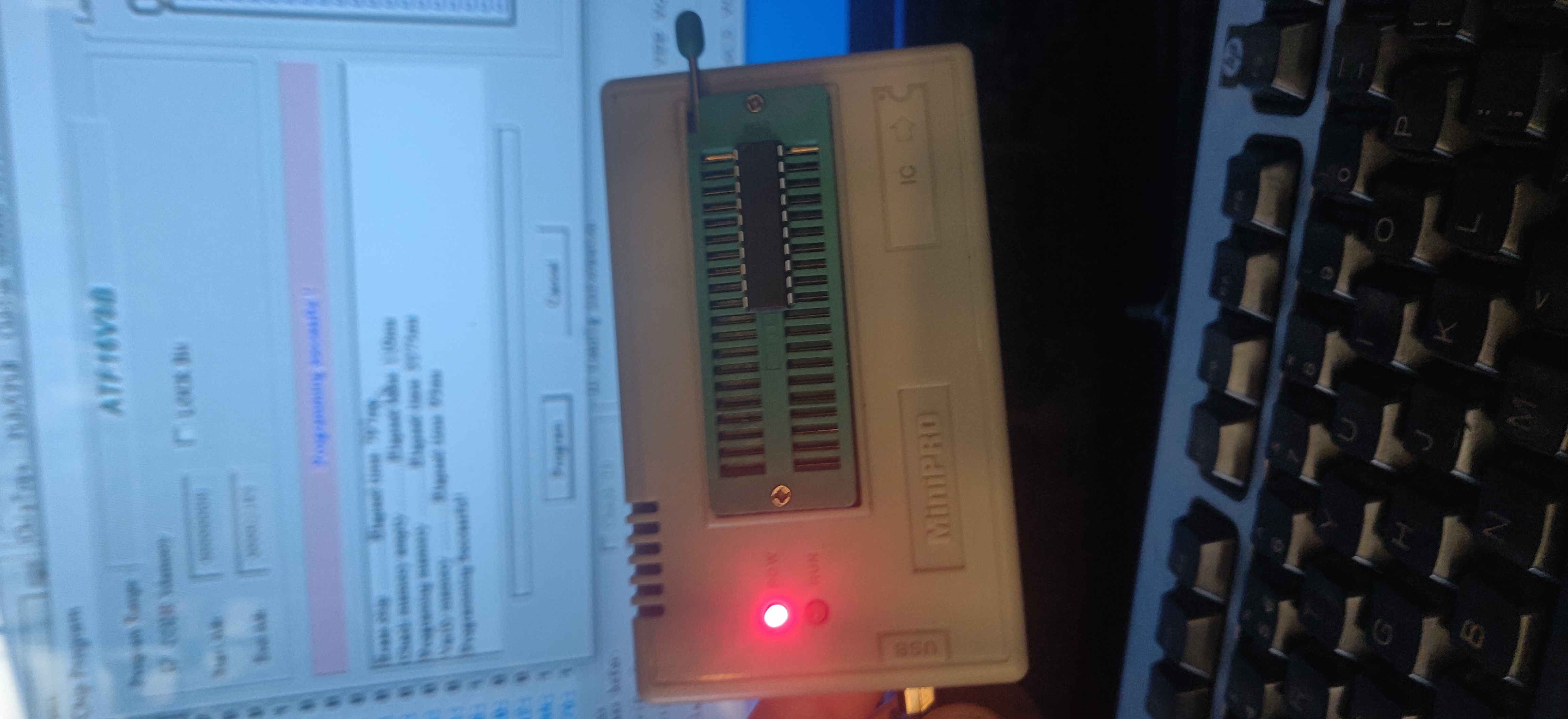

hi i need help
my lemans 24 has 2 dead pcbs on the driver
i tried to program it see photos
but still no output from the display one show a flashing . on the leds
the other one is dead  :bail:
is someone able to help or is njz3 going to make it drive the motor pcb from the 2650 mega??
Tibal
There is no replacement for American/Europeean Le Mans 24 Driveboards to this day.
I see you're flashing ATFs but only GALs are proven working. Maybe you should try with GALs
